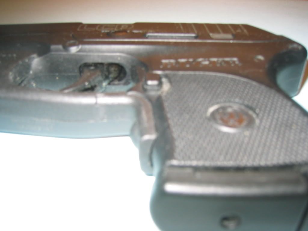

Not my best photography, but here is a picture of my "flat" slide lock tab.
Re: LCP slide release ("hold open") replacement
Oh... Then I think mine CAME WITH THE UPGRADED tab already pre-installed by the factory.
