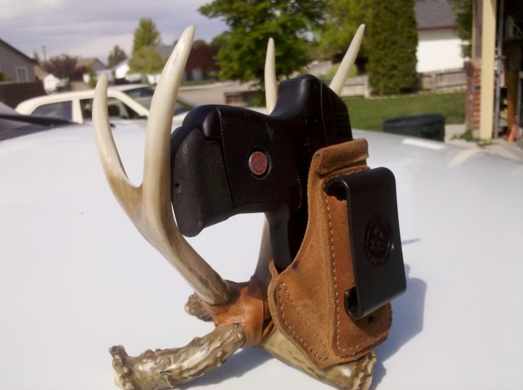

Weird photo better than no photo. What method did you use to fill in the Ruger logo?
Those are Ruger medallions that I found online. They were too thick so I had to make a jig safely hold the medallion while sanding about half of the thickness. To prep the weapon handle I used an xacto knife with a 1/4 chisel blade. It was easy to remove just the raised portion within the circle. A drop of epoxy glue holds them in. The medallions come in red and black and I thought the red would look good.
I modified the front sight and installed a fiber optic. It is really bright! The exposed part of the barrel got a jewel job. Den

Those medallions look great! How did you do the fiber optics?
Thanks for the medallion complement Vexmaw!
For the fiber optics I removed the front sight from the Custom. The sight was mounted in my hobby vice protected with soft jaws. The sight already has a hole started for their insert so I simply drilled the hole all the way through. I used the hand drill my Dad gave me when I was 8 or so. A small bevel was made on each end of the hole. A window was filed in the top middle of the sight to let light in. After all the sharp edges were removed, the sight was cold blued. Next the fiber was installed. It came from an unused shotgun front sight. Cut to length and heat each end to form a little ball. Den
